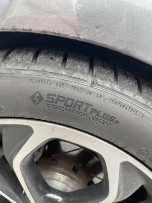

My new Conti DSW06 Extremes ride funny
Cheesehead
Jan 26, 2020
126
64
Schofield, WI
I will tighten down the lugs and check tire pressure, but I am getting vibration around 90 mph but nothing drastic. You can just feel it in the steering wheel where it's a high rate feeling, and not where the car shakes. Could it just be the aggressive tread? I just thought they would ride smoother. I can definitely feel the road much more. Is this to be expected? I know everyone loves them here which is why I got them, so maybe it's just a new tire feel that I wasn't expecting, but not necessarily bad.

Maybe. Maybe they are slightly off or the balance is slightly off.
7,406
9,702
I would verify tire pressure first, and then check balance. Mine are quiet and smooth and I run mine at 43 psi.

I just had a set installed. Ive been good but ill check pressures also. Maybe your balance shop did a poor job. Rotate the tire to other end of the car front or back and see if it follows. Then you know somethings wrong with it.

The "+" model's have a little more Road feedback than the old DSW 06's.
I've noticed that the plus model's are also noisier on Fresh tarmac.

I have the ++ on our boosted ’19 Flex and they are darn smooth, I’ll second that one is probably out of balance. I run that car at 40 psi

Well I think putting the pressure at 43 helped quite a bit and pretty much eliminated whatever I was feeling. Just a tiny, tiny bit of the steering wheel feel around 90 but nothing to complain about. I will get them balanced again in the spring after the winter rims/tires go on and off. My buddy just got the Sport ++ on his Maxima and raves about them after bad experiences with his last set of Goodyears.
13,266
Not sure what year you have but also to consider worn suspension, alignment, wheel bearing. Less of a possibility but something for the mental file for later.
