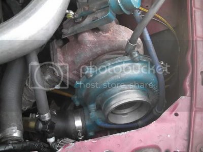

NCTaurusSHO said:
here is a pic of the turbo (old piping setup though)
wow 392tq!! is tha tat the wheels?!?!? NICE! kicked the crap outta the 350tq limet iv seen most ppl dead end at for what ever reason i dunno.... well my cars not gonna be done fer a while.. i have a kid on the way in march so i dont have much money to spend right now. but yeah 400hps my goal on low boost9-10psi well i gotta run. ttyl man ill keep yas updated.
p.s. it would definitly be a interesting race.. see how 1 big hunkin turbo goes up agenst a seqencial setup.
