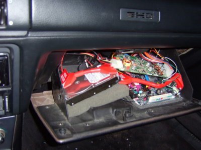

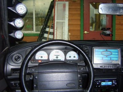

I built one for my SHO a few years ago. 1GHz Via Mini ITX motherboard with an Opus DC-DC smart powersupply in the glovebox. In-dash 7" touchscreen. Here's a few pics:

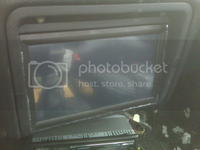

First off this is my 8" Lilliput touch screen and modified bezel epoxyed into place (this is not a finished product and I know you can see the epoxy lol)
second have my laptop that I picked up off Kijiji for like 200 bucks, its a dell inspiron 9200 with a 17" monitor blah blah blah... its a fast computer but way oversized but the deal I got on it I couldn’t get anywhere near the performance of this one for 200 bucks.
Third or soon to be third, I will have my tweecer r/t and will be able to tune and control my engine and display all my stats…
It’s pretty cool. Don’t mind the temp wiring and duct taped head unit as that is temp as well until I buy my new amp for the audio. The laptop is temp until I have more funds this summer to put in a real car computer and have a nice install.
-mitch

Thats roadrunner right? Could you send me the skin for that? thats pretty good! im probably going to run centrafuse as its much more polished than the roadrunner app but it comes at a price though.
