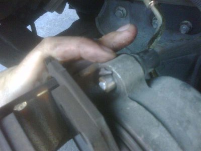

Sho help braketastrophe1

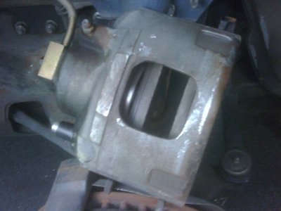

And this one:
Sho help braketastrophe2

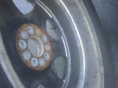

This might explain things better:
Sho help braketastrophe3
Sho help braketastrophe4
The moral of the story: make sure all of your brake caliper pins are nice and snug! I'm going to run off and pray now...
On another note, I found out what that grinding noise was about!

That was my thought. I have very fortunate break downs. I only had to travel about half a mile with the caliper contacting my rim. Now I have to extract the bolt that sheared off and get a replacement. I think I'll be replacing the hose too just in case.

It looks like whoever worked on the brakes tightened the slider pin too much or did not grease the slider pin, and the pin got stuck in the boot.

the bolt broke, good luck getting the old one off
now might even be a good time for a knuckle/brake upgrade so you don't have to deal with those pos brakes....... how long has it been since that bolt has been removed on a brake job or such?
also u can't really tell from the pics how deep the groove is in the wheel, but if its noticeable, I'd have the wheel checked out by a wheel repair company and get a professional opinion from them wether its safe to use or not

Yeah, my phone doesn't take very good pics.
The groove isn't very deep at all. Probably as wide as a pencil and a 1/4 as deep.
I can only blame myself for the brakes! Though a set of upgraded ones aren't in the cards yet. I got new pins and a new brake hose, so I'll check everything out when I go back to the car.
The new pins have thread locker already on them luckily.

I think thats kind of silly as long as its torqued to spec, or tight enough to your standards(I.E. the bicep torque wrench) I do brake jobs left and right and have never replaced caliper bracket bolts on any car... never had an issue
also the threadlocker won't help out in a situation like this
that probably happened from tightening it too much, which gave it a stress point or crack that was weakened and over time it gave out.... I wouldn't loose too much sleep over this if you fix it with new parts and install it correctly... now if this is a reoccuring problem.. then I'd be looking at something else causing this immediately
