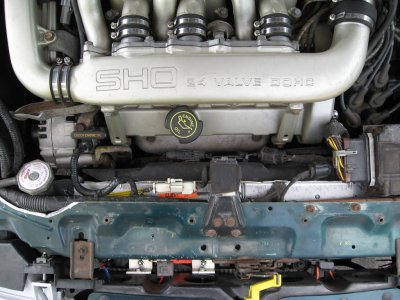

You're going to have to modify the ATX shroud to fit. The ATX radiator is a little different than the MTX radiator. I don't know if the connector is the same between an ATX and MTX, but I believe there are only 2 wires that go to the radiator fan(s), so it should be pretty easy to wire it up. Even if they are different.
The picture is of an ATX with a dual core radiator meant for an MTX. The driver side of the ATX shroud mounts to the radiator just fine. The passenger side needed a simple bracket on the bottom to hold it up. The top side I took out 2 rubber spacers from the shroud and ran a sheet metal screws into the sheet metal lip of the radiator. I later drilled them out and used a bolt instead (not pictured).
