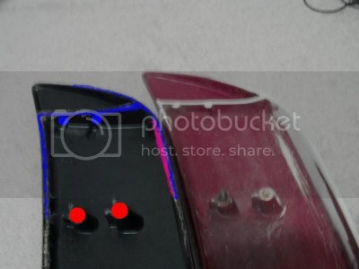

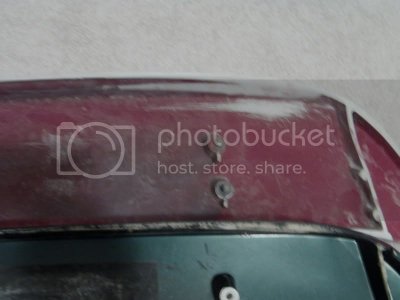

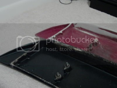

exactly what did you do to make it fit that good??
It wasnt really that bad honestly. All I did was take the screws out of the spoiler just to get an idea of where to start sanding..wasnt really much modding I needed to do. I inserted some pics showing were I sanded..you wont get too good of an idea with the pics, since they sucks..haha. but anyways in the pic where it is blue I sanded to where it would lay flush with the body, you have to do quite a bit of sanding where the back part meets the side part of the spoiler (the straight piece of spoiler ((looking at the underside of the spoiler)) running straight with the gap between the trunk and rear quarter panel) wont really lay flush until you sand where I painted the pic red where the screws go into the spoiler. Also you have to sand the back of the spoiler where it would lay against the back of the trunk, as flat as you can get it...you have to take a good bit off. (painted in pink) pretty much you will be taking it off and putting it back on about a billion times..and when you get all the sanding done you are not finished yet! (this is where I am at in the project) no matter how much sanding you will do there is going to be a noticeable gap on that back part of the spoiler where the 3rd brake light is to the trunk. so you will have to get some fiberglass and go to town at it and get it flush. I was trying to do it this weekend but got caught up. It looks good as it is now (with the gap) cant notice it really unless you open the trunk and it is staring right at you! haha. I dont know if I will be keeping the spoiler once it is done, I pulled a Thunderbird spoiler and will be getting a new trunk lid to try that out, see how it looks. Seems like it will look good after placing it on the existing trunk.
