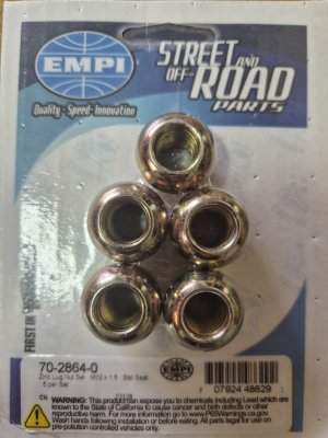

I got the correct lug nuts for the Volvo Canisto wheels. The M12x1.5 Honda lug nuts I was using had a R13 ball seat. I did some research and the 1.5mm difference matters when it comes to clamping force, so I purchased these R14 lug nuts. This size is pretty uncommon and not easy to find. The only vehicles using them are vintage Volkswagens and Porsches with wheel stud conversions. 20260606 183622
