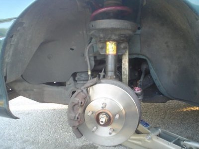

Just look for the different calipers. I don't have pictures of the earlier knuckles but they don't have such huge eyes for the caliper. Also, the earlier knuckles don't use caliper brackets, the caliper bolt directly to the knuckle.
'89-93 calipers..
Dsc01468small
94-07 calipers
Dsc14162

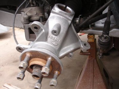

Here's a '94-95 knuckle...
Dsc03237

The earlier knuckles have large protrusions for the brake pads on the old style calipers to ride against, and small threaded holes for the caliper sliders. The newer knuckles have no such large horizontal protrusions, and large non threaded holes for the new style caliper bracket bolts to go through.
93rev2sev
Nov 1, 2004
6,461
1,825
Hockeytown
As you can see in the pic above, the 94/95 knuckles just have those 2 little tabs on which to bolt the caliper. The earlier knuckles have HUGE ears that hold the pads. Those huge ears are cast into the part.
