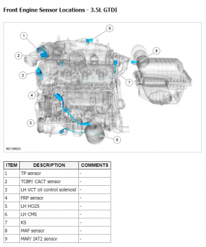

Thanks for this picture. Regarding no MAF sensor the shop manual shows that there is one right at the location of the air filter, item number 8 in the picture below. This is the correct engine diagram for the SHO right?

#8 is mislabeled. #8 is the IAT - Intake Air Temperature. On some vehicles with a MAF, the IAT is combined with the MAF. Not like this on the 3.5 Ecoboost.
Yes sir, I second this.
7,431
9,732
Ok, thanks for the responses. Glad I didn't pay for the manual. So items #2 and #9 are the MAP sensors correct? And the IAT at #8 gets cleaned with the same CRC cleaner?
Yes, correct to all.
