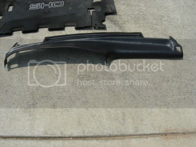

Need some to paint this awesome Coverlay dash cap I found at the j/y on an 89. I was able to gently pry it off undamaged.
Any idea where I can get an exact match paint and how I should prep/paint this thing? It just glues on over your existing dash. They retail on Coverlay for $145...picked it up for $20, so I can avoid a dash swap now even though I need a BDA.

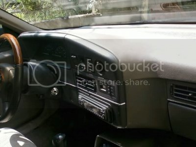

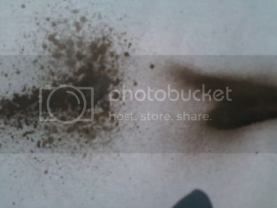

SSPX0015
SEM on the left and Dark Titanium on the right. The SEM spray can ran out of propellent and that's why the splatter but as you can see, they are a close if not perfect match.
Definitely degrease it and take a fine scuff pad to it before painting.

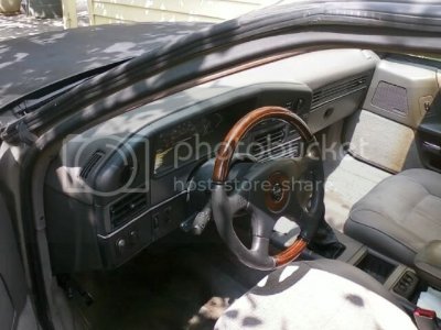

What it looks like installed:
SSPX0016
SSPX0017
