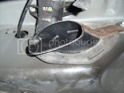

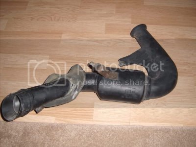

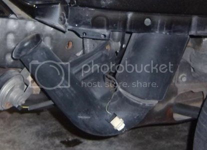

Look up "Troxel Intake Mod" on the V8 sho forum
Don't porterize it. Troxel it to get cold air intake. See V8 sho. Much cleaner look.
The first view is the cut off intake installed. It picks up cold air in the fender well. This view is with the splash guard removed.
