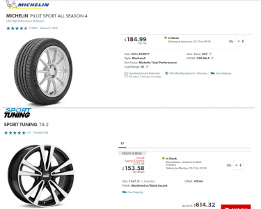

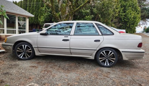

I am looking at getting rid of the slicers on my '90 and moving to aftermarket. I found some 17x7.5 with a 45mm offset, running 225/45ZR17 Michelin tires. Any thoughts on fitment? Ride height is currently stock. Any help would be appreciated. I'm terrible with tires and wheels.

Pulled the trigger. Earlier last week the rep said they would fit, but today said that the width is a little bigger than they were comfortable with, but *should* fit. Apparently I can return them if I don't drive on them, but hopefully that won't be necessary.
+45 will probably be too much backspacing for a 7.5" wide wheel. You might end up needing a 5-6mm spacer to clear the struts and then you might need longer studs in order to get proper bite with the lug nuts. Extended thread lug nuts should probably be used if spacers are required.
My personal guide for SHO backspacing
7" wide +35/38
7.5" wide +40
8" wide +42/45

Thanks. They're actually an inch shorter than my old tires so my speedo is much more accurate.
My old tires definitely needed to be retired!
