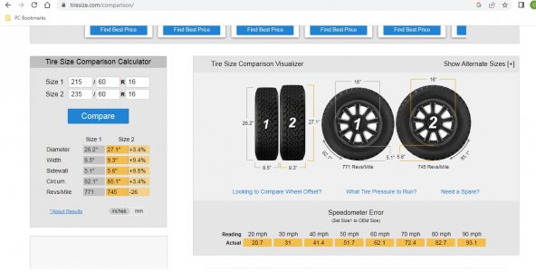

Hey! I need new tires on my 1992 Taurus. The stock size is 215/60/16. I found some damn near new tires for 100 bucks but they are 235/60/16. Do you guys think they will fit??
7,522
Those tires will be an inch taller and nearly an inch wider than the correct size. I think you will have rubbing issues when turning and may need to roll the rear fender to have it not rub there. You will have less acceleration by about 4% due to the diameter difference, and it will reduce your gas mileage. If I were looking at that, I would pass.

Ok, what about some 225 instead?
