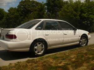

Hey guys.. I just picked up a 94 ATX sho off craigslist for cheap.. It had the NESHOC stickers on the rear 1/4 windows... I was wondering if it was any of you guy's car.. Its a 94 white, grey full leather, roof, with 116k ... Looked bone stock other than the lower airbox had small holes drilled into it.. Its coming with TONS of maintence records and things really nice.. Truck/spoiler needs paint cuz of ford quality paint but other than that its really clean!
Any of you guys?
heres a pic
