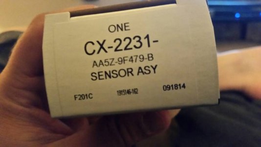

Have to call LMS tomorrow they may of sent the wrong one it's not matching up with the invoice. says AA5z 3 bar map on the invoice from LMS, mine has the AA5A markings on top.
98eeaea30fc4460c11634902729d480a this was the 3 bar i bought.

Gilbert
Index
sweet thanks! I have the same box but the numbers don't match up. Now I just was told by the guy who tuned my car that I dont need this???!!! Why does everyone have 3 bars in? the tune pushes the PSI well over its 14.5 stock 2bar? LOOKS like I'm going to get that LMS tune after all......on the 1st payday
