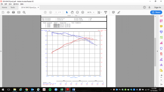

My business trip got canceled so I was able to jump on this project a lot sooner. *I want to start off by saying it is NOT my intentions to bad-mouth anyone or try to hurt a business - all I'm doing is providing real-word results and factual conditions regarding my car.
I have 2 results to provide: 1) Dyno Results and 2) Shifting Issues:
I loaded the canned tune from Gearhead (it's their automatic octane adjusting tune) and installed new 542 plugs gapped to .027. That's all I did.
Again, my mods are 3-bar, Windstorm CAI, 542 plugs, 160 thermostat, and Magnaflow Cat-Back.
Mustang Dyno Results:
  1. LMS:
    • 333 WHP
    • 390 WTQ
  2. Gearhead:
    • 347 WHP
    • 398 WTQ
Not a huge increase but it's more.
Shifting Issues:
LMS
93 V11 tune. My car would act like it pops out of gear into Neutral mostly from 2-3 shift under WOT and rev up to like 8k. Also, when cruising on the highway anywhere from 50mph+ and I floor it, the car goes but there's a minor hesitation / sputtering type issue going on. The car accelerates but you can feel a hesitation at same time. LMS has been excellent in communicating with me on this, however they said it's probably a fuel pump / module issue and there's some TSB about this, could be fuel pressure issue, etc. Well.....
Gearhead tune. BOTH shifting issues are now gone! I loaded my Gearhead tune 3 days ago and been running around town, I put about 40 easy miles on it then started some WOT runs. From a standstill, 10mph roll, 50mph roll, etc the shifting is flawless and no hesitation. And it seems weird but the shifts are lightning fast, not harsh, just instant.
*Last note: my performance shop said they really liked the new tune I installed (they didn't know what tunes I had or where they came from until after all these tests). My performance shop said the shift points are much better and that with the smaller turbos on these cars the rpms don't need to be high as that actually hurts the performance and a bunch of other real technical stuff I honestly didn't understand! I should've recorded them on video.
These are just my results and not intended otherwise. I appreciate all the feedback and discussions we're having on this tread - thanks to everyone. Good to luck to all !!! :burnout:

I wonder if you were having an issue with fuel pressure on the LMS run, that torque curve and horsepower curve took a hit...twice.
Your HP curve is actually pretty impressive up top on the LMS tune, it didn’t just fall off after 6k rpms. This shows that even at the higher rpms LMS is still developing good power from the smaller turbos.
However the Gearhead tune pretty much is developing more power through the whole curve and not just at peak...
I wonder what the LMS run would look like if you were not having fueling issues.

Did I miss a datalog, OmaHahn? Since you have an SCT device you can log how your SHO runs on both tunes and compare. A fueling issue should be pretty obvious especially if you are running higher E blends.
He has been complaining of stumbling in third gear under WOT with LMS...
If you look at the dyno run between 3700 and 4300 rpms the torque and hp take an unnatural dip... and then again after 4900 rpms.
In any event, it’s pretty clear that his car has a much better curve with the Gearhead tune and based on the dyno and feedback is a better tune for his car.
And a completely missed shift from 2-3...goes into Neutral and revs the living cr@p out of the motor! :)
