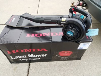

To be fair... mines a honda... they wont tune honda's... I do have an email in to Gearhead however..
Mower

Its a good mower thus far.. my Husqvarna motor finally died after 6 years... this one moves! My neighbor was laughing causes I was literally running behind it to keep up.
Oh.. and I "fit" it in the trunk of the SHO.. hung out a bit.. but fit.. (ish)
