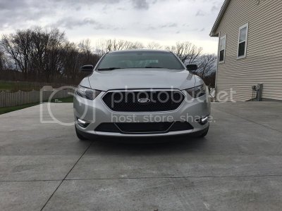

Update,
I ordered the LED lights from Drive Bright and got them installed today. I only got them working and yet to hook them up to the turn signals. Overall, I LOVE THEM! They are super bright!
The below picture doesn't do the lights justice. They are WAY brighter in person. I will post more photos in the next day or so.
At $230 they were a bit pricy but I'm happy with them.

Did you get them painted in a certain color? I got the Silver ones to match my car, looks sharp and OEM! Love mine too!
