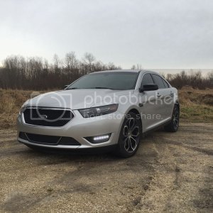

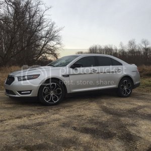

Update:
In previous posts I was having trouble with the 'courteous light' harness from Drive Bright... Well, I tried the trouble shooting steps that Dan at Drive Bright suggested but it didn't work. Luckly, he suspected it could be the wiring harness it self and shipped me one that day..
Turns out, it was the hatness that was bad..
Now the lights perform like they did with the factory lights.
Image 4
Image 5
