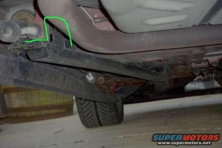

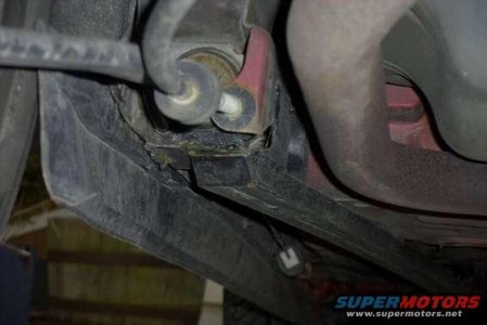

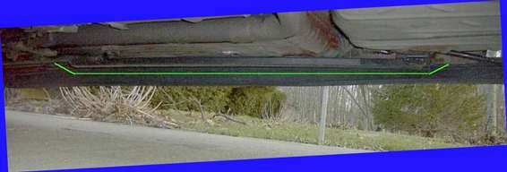

As does the short subframe connectors. It is immediately noticable. Also gives good jack points.

You would have to make the brace custom no? Though I agree completely with you my train of thought was things readily available to buy and things I had experience with. Both of those I have none with.

Use the regular shorty braces but you have to box in the forward strut tension rod bushing area. Good Idea to change them first......

There were pre-made front strut tower braces available. I bought one half a dozen years ago or more, but I do not think he is in business any more. Might try NESsho or FPS. Anyone know if there are any pre-made still around?

How is that suppose to help handling? It doesn't look like much (or connects to anything in particular)
