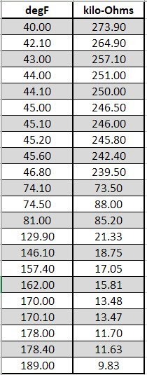

If you want an accurate PTU temp, you could get an external guage and wire it to the temp sensor on the PTU. Not ideal, I'm sure. It's just a 2 wire resistive type temp sensor. I took a ton of readings on one to attempt to figure the scaling. I still have that data if ya need it.

Nice find, here are the findings that I had made:
https://shoforum.com/index.php?thre...maintenance-thread.142193/page-2#post-1553646
