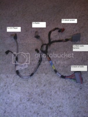

It is plug and play as long as you have this harness for it.
IMAG0022 1
Not sure about the CD changer. I think those only were in the 96 and up cars.
