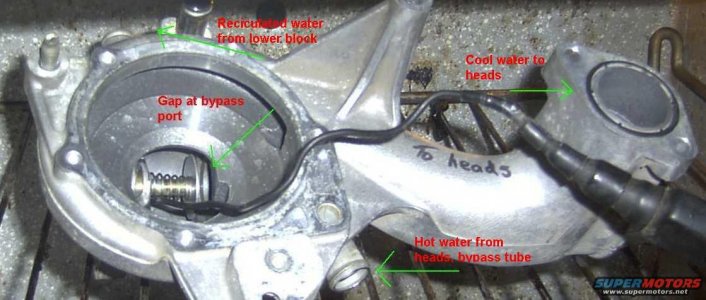

I had a NAPA 170F t-stat and found that the bypass did not fully close on it. This would let hot fluid be recirculated instead of shutting the passage off and drawing in fluid from the lower hose only.
This picture is taken after the pump and t-stat were heated up to 170F in the oven.
This is a GEN 3 pump but the sealing of the bypass would be the same on any water pump.
T stat in water pump at 170f in oven
