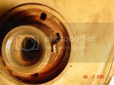

Here is what crank cancer looks like in the beginning stages....
Josh065
this was caught in time, and was repaired.
Josh065
Mine didn't even make it that far... It broke and the wore the crank.
If you think it may be crank cancer, do the work now and pull it apart to find out... Or, Just torque the crap out of the crank bolt.
