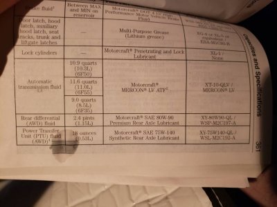

Tulsa, OK
The pic above is great specification. I stick with Motorcraft Mercon LV for the tranny (get it cheap AF through the dealer if I bring my own bucket) and then I use Redline Synthetics 75w140 for the PTU. Haven't done the RDU yet.
