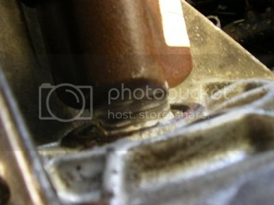

Is my left axle in all the way? (pic)

It seems like it should go in father, but I don't want to force it. If someone could take a pic of theirs so i can see the difference, I'd appreciate it.

Yes a little harder on the pushing. You need to get the c-clip on the end of the axle to seat inside the differential.

just pushhhh and breath and pushhhh and it will go in eventually:rofl:

Thats as far as it'll go... I wont pull out unless I use a pry bar, and it wont go in any farther. I tried everything, even hammering on it! (lightly) :evilgrin:

half-way there, I think.
Push harder :nut: It can be a biotch to get it seated, but it will go.
Kinda get a running start at it. They can be a pain sometimes. Also make sure the c-clip isn't mangled. That could be preventing it from seating correctly.

I really think its seated. If not, I'll find out. Its goin for its first ride in about 5 minutes!
