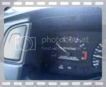

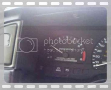

Here's a video of what happens when the miss occurs:
Th video 2010 04 05 11 21 59
Th video 2010 04 05 11 23 58
Any suggestions?
