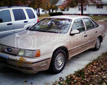

Sunday i got a 91 front bumper cover from a fellow SHO forum member just an hour away,i think i can live with the interior for the time being as its not as bad as i had first thought,i just picked it up today as it was at a friends shop for the last 3 days being gone over because it had been in storage for a couple of years,it went there straight after i bought it,it now runs & stops great.

For some reason I was thinking you picked up an 89, so I thought my bumper was going to match color-wise. Once you sent me that picture I realized it was Moca. I'm still pretty jealous at how nice the body is on that thing.
