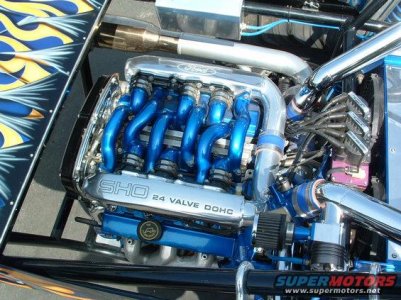

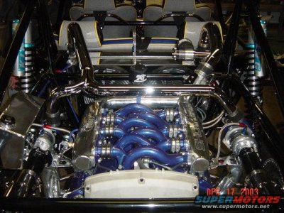

Yes, it will run without the balance tube. The inlets on the primaries and secondaries inside the side plenums do not point toward the throttle body. They are neutral. The air from the throttle body can be fed in either end of the side plenums. Some people have taken off the crossover tube and attached a throttle body on the end of each side plenum. The intake horns of the secondaries are pointed straight at the flat part of the side plenums, not left or right. Do not remove those horns, they aid in the smooth flow of high speed air above 3950 rpm's.

Man, If only I had the patience to polish my intake. Those look awesome. As far as removing the horns. I removed mine for my BBB. Were you talking about a not removing them on a stock intake? Would a "custom" set of horns for BBB help with airflow? ......just kinda thinking out loud.
