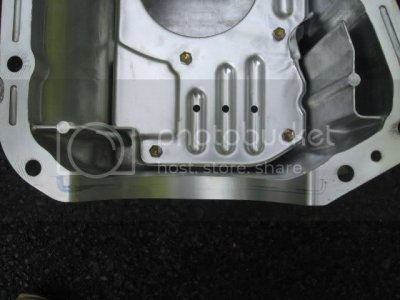

Oil Eater from Costco does a great job on the oil pan, valve covers, etc. I use it full strength, let it soak 30 minutes or so, and hose off. The results:
SHOoilpan

thats pretty impressive itwonder.....
I recromend simple green also for your timing cover and coil cover... or just junk the coil cover
spray it down full strength, and use a brush... works fairly decent and isn't harmful
for the metal intake stronger stuff is highly recromended, that oil eater stuff looks like it does a damn good job......
