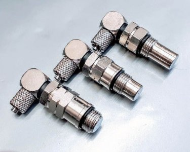

AEM nozzle has a built in check valve but the O-ring that's in-between the quick connect and check valve already failed. When I purchased the kit, the 250cc was already installed by AEM and brad wanted me to use there smallest nozzle so I never took nozzle apart until my rough starts where getting out of hand and that's when I saw ring smashed and cut on one side, whoever assembled it before it got to me obviously didn't care about there work. When I ordered a devils own nozzle this morning I also got there check valve and low profile holder. And yeah I kept thinking of putting pump down there, but after sitting on it for a night I went this route, not being tuned for meth was the only reason I did what I did that and time of install. So even if there is a failure, I wont suffer the consequences nor have to take front end apart to start over.
The concern isn't between the pump and the nozzle, but more between the reservoir and the pump. If the fluid backfills into the reservoir and replaces the line fluid with air, you'll **** all that air into the pump and it has a potential to cavitate the pump, rendering it useless until evacuated and primed. So you would usually place a check valve at the reservoir to keep the -4 line full of fluid and reducing air volume.
The check valve on the nozzle is to keep the nozzle from sucking air back into the system when you stop injecting, much in the same way our DI injectors need a check valve to prevent combustion from creating back pressure on the injector and cavitating it as well.
My placement of filter above pump was in the theory to keep liquid above the pump at all times. Problem I had with the AEM nozzle is the failure of the o ring which allowed the engine to syphon what was in my line even at startup, by bypassing the check valve in the nozzle. I do appreciate the advice and will look into placing a check valve at reservoir.
