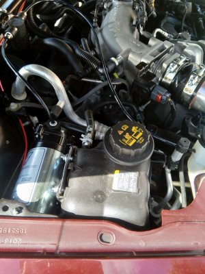

My first round with Brad AJP turbo is done. My car has a 92 AO tune . I must say he knows what he is doing. He understood I wanted, to run meth but not be dependent. So we made a compromise, my degree of timing being AO tune allowed me to run a AEM 50/50 kit with a 250cc nozzle and not being tuned for it. I've done 2 dozen runs to engage the spray and the car responded instantly and had 0 issues.And my b u t t Dyno was impressed. I did a log for Brad without meth and my iat2 hit 150. I have logged same 3 pulls for myself and with meth the highest temp was 105, these pulls were done on 95 degree days. Biggest plus is I get more cooling and a little more power. And if I have a meth failure the car can adjust without the worry of damage. Very happy with the result. Keeping meth for the next step into a E30 tune. After E30 and when DPs arrive I should be at 400whp and 500tq on stock pumps, and stock IC. Not bad for not being meth dependent. My car gets the high without the overdose.The filter is above the pump and the nozzle is higher than the pump And I used the washer tank. I start for spray at 7psi. A full on/off setup, non-progressive. Here is some pics of my install. I know some might cringe on where I put the pump but it works just fine. It cut down my I install, only took 4hrs.

Oh yeah Brad is the man! The pump install is not where I would have put it but if it works….that’s all that matters. You can access the pump, check for leaks, etc without pulling off the front bumper.

That was the plus. Not having to remove front bumper, I know the pumps like to be gravity fed, but I took this approach, a heck of alot less tubing, less wiring, easy removal of pump if it fails.i mounted filter above pump as to keep some fluid above pump at all times. If pump fails early before 2 years I'll relocate at that time.

Setup looks clean, are you running a check valve to prevent pump cavitation? That's my only concern with running the pump where you have it and being about 18" above the washer tank. Typically you always want to mount the pump BELOW the reservoir.

AEM nozzle has a built in check valve but the O-ring that's in-between the quick connect and check valve already failed. When I purchased the kit, the 250cc was already installed by AEM and brad wanted me to use there smallest nozzle so I never took nozzle apart until my rough starts where getting out of hand and that's when I saw ring smashed and cut on one side, whoever assembled it before it got to me obviously didn't care about there work. When I ordered a devils own nozzle this morning I also got there check valve and low profile holder. And yeah I kept thinking of putting pump down there, but after sitting on it for a night I went this route, not being tuned for meth was the only reason I did what I did that and time of install. So even if there is a failure, I wont suffer the consequences nor have to take front end apart to start over.
