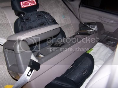

I ended up pulling the console since I couldn't get my big hands in there otherwise.
It was necessary to really crimp the Mopar clip closed with a big pair of pliers before installing it (I pushed it downward from the top. I then put a zip tie around the top of the clip to prevent it from backing up and releasing.
Frederick volunteered to reinstall the console since he wanted to get some confidence that the repair was going to hold and that, should it not hold, he could get in there and manually hold it together.

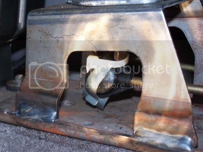

Steve, once again many thanks. This old 18 year old car would certainly not be on the road without your handy services. As a reference for others who run across this issue, I wanted to share the following photos to go along with Steve's write up on the fix.
000 0120
000 0122
000 0121
So what am I supposed to do with this leftover piece?...
000 0123
Thanks again.
