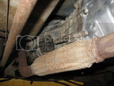

Well on my Luv Diesel it had a large spring that ran from a bolt on the trans case to the pivoting "bar" that is pulled in and out when you push on the clutch pedal. Clutch quadrant? Sure!

Yeah something like that. Is there a spring on the SHO transmission like this? Maybe this is missing???
IMG 0088
I miss that pickup :(

Nah theres nothing on that... those forks have broken before tho.. that is a possibility.. the thing I was talking about is on the pedal side.
