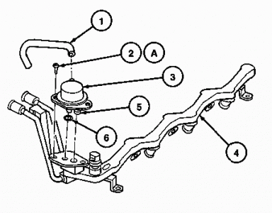

This may be a stupid question as well, but have you checked for cracks in the manifold to FPR hose? I threw codes for running lean then rich then lean like you have been getting when it wasn't properly secured before.

three50one, now i know which one you are talking about, not that hose is just fine, and i remember that i could even pull that hose off at either end
