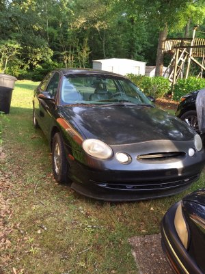

Yes! PLEASE FOR THE LOVE OF GOD SAVE THIS SHO! From the pics it still looks pretty clean.

Well, she’s not as clean on the outside as she was in those pics, but it won’t take much to get her looking good again. A little wax and buffing and she will clean up nicely. The interior is spotless though. The 2 piece bra is in the trunk as well. The rims still have a mirror shine, I guess from all the never dull I used to use on them. I last drove the car this past December when we bought a new house, had to move the car, ran a little sketchy at first but then smoothed out a bit, drove her 4 miles to the new place and parked her. It’s gonna be a process but she will look nice again soon.

I just took these pics. She’s a little dirty but all there. Dang sun glare!!!!Eb5e06b48c1818284ff427d1ce276cfd

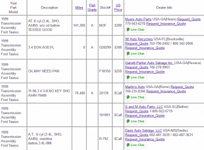

Since these cars are doomed to die of cam failure, there's probably good transmissions out there (whereas others cars might have gone to the wrecker because of their tranny). Here's some a drive away:
ZOXPe4c
If you need a transmission for "without overdrive button" you can do the same search on car-part.com.
