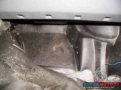

Not to threadjack, but does anyone has a decent zoomed out picture of where the hole goes in the floorpan for the subframe warranty kit for either side? The Ford instructions aren't that great, and the only interior pic on SHOPhoenix is superzoomed in on the hole.

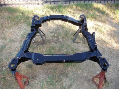

Great write-up btw.
Like my version better. . .
Correct me if I'm wrong, but that looks like a stock subframe. Why not a GEN 3 Subframe instead? Kinda seems like a waste of time to do all that work to a stock subframe. Looks nice though.
