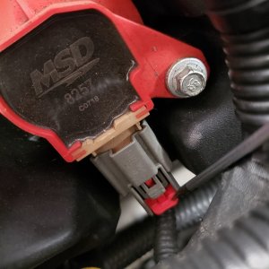

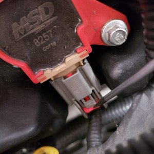

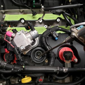

First thing is getting those connectors off the coils. Slide back the red clip on the coil connector, it's easy enough with a small flat head screwdriver:
39GuurYj7mA8Lwidth1024height1024cropmodenone
0Ab8OzbaC LLywidth1024height1024cropmodenone
Then just press the clip retainer and slide off the connector. After disconnecting that, use an 8mm socket to remove the coil retaining bolt, then pull out the coil. Even though I only complete one cylinder at a time so as not to confuse things, I still typically mark the coil with a sharpie identifying which cylinder it came from.
Before you take out the old plug, it is important to use some air to blow out any debris that may be residing in that spark plug well so that it doesn't fall into the cylinder. You'd be surprised how much junk gets blown out of there, despite them being "sealed".

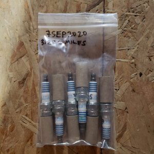

After pulling the old spark plug, I look at the condition of it, mark it with a sharpie as well and I personally keep my old plugs for at least until the next plug change to compare them to the previous set. So they go in a zip lock and stored away.

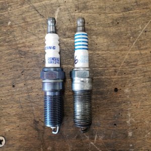

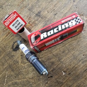

Here's the new plugs:
MZQMEw51dPSySwidth1024height1024cropmodenone

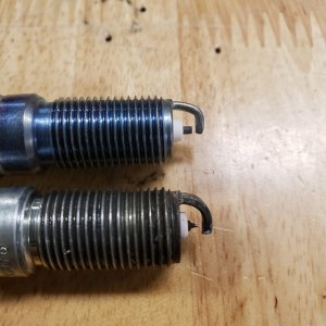

Side-by-side comparison:
20HAWEzJ4Pmmdwidth1024height1024cropmodenone
Tip/electrode difference:
9 M6gSrXjABuCwidth1024height1024cropmodenone

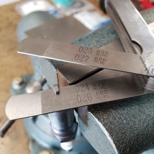

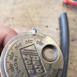

I had the SP-542s gapped to 0.26 and went with the same on the Brisk plugs.

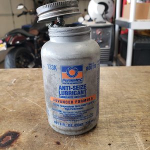

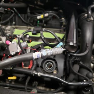

I use an old piece of rubber hose to put onto the end of the new plug as it makes it a bit easier to install by hand into the well. But before I install it, I give it a good thin coating of some anti-seize. You will thank yourself later if you do this, trust me.

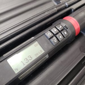

Factory service manual says torque to 133 in-lbs, not much, I know.

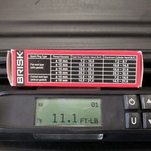

If you convert the in-lbs to ft-lbs you get 11.1. Comparing to the recommendation provided by Brisk, it falls right in line (the plugs are conical seat, 14mm thread diameter going into an aluminum head).

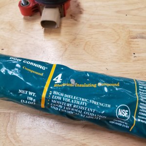

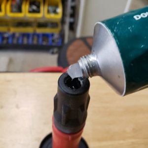

After installing the plug, make sure to use a small amount of dielectric grease (I like to use Dow Corning #4) inside the coil boot to help keep moisture out as well as ensuring it doesn't adhere to the plug and become a nightmare to remove for the next plug change. In the photo showing how much is coming out of the tube is the amount I usually use.

After that, installation is the opposite of removal.
Some tips to be mindful of:
1) If you have the composite valve covers like I do, be very careful when torquing the coil retaining bolt. The threaded hole is just a metal insert that can spin on you if over-torqued. If you spin it too badly, that's it...I don't really know of a fix other than getting a whole new valve cover, maybe some sort of epoxy. The book says 62 in-lbs, then another 50 degrees, but TBH, I did that spec on one of my retaining bolts the last time I changed the plugs and it began to spin (yes, I checked to make sure I was in-lbs and not ft-lbs). So before I let it get too bad, I just left it. Luckily it was in pretty tight and didn't have any issues the entire time I had those 542s in. This time around I was just very careful to do it by hand and get them as tight as I felt comfortable. That seemed to work pretty well as they are all solidly in there.

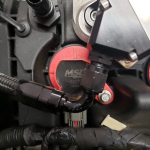

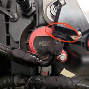

2) If you have an XDI HPFP, you're going to have to remove the low and high side fuel lines as well as the top 2 bolts to spin it a bit to access the coil on cylinder 4. I think I heard XDI had a redesign, but can't confirm that.
ImXbQUY 9b4eiwidth1024height1024cropmodenone

Note on the fuel pump...
It is MUCH easier to just remove the -6an male low side connector on the pump vs removing both lines, bolts , and spinning.
So remove the low side fuel line, use a 17mm iirc wrench, and unscrew the adapter from the pump. Take no time at all and will let you get the number 4 plug/coil out.
916237c6d100da86537b8c50c76550f1
Ah....very nice catch. I will try that next time! I wasn't sure if there was some sort of spring or ball valve or something behind it that could fall out and be a nightmare to assemble again. But good call...
There is a rubber o-ring on the back. Other than that, you are good to go!
