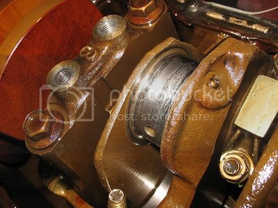

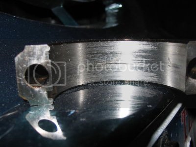

Ya I know what you mean, the bean had less than 140k on the clock and here's what it looked like when I took it apart:
Badcranksmall
Badbearing
I was going to put this off until NEXT payday...but I'm going to go ahead and do it now. $67 now and not a lot of lunch for the next week or so is better than a new car later.
