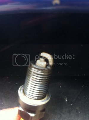

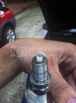

Old plugs: Autolite Coppers. Normal heat range.
All plugs looked like this.

This plug was from the back middle cylinder and shows the most sign of detonation.
Note the porcelain chucks missing.

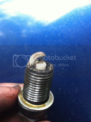

I put new plugs in, ran them for 15 miles and pulled them. These are NGK's platinum's.
547719d6
This was on the back middle cylinder. The black spec is melted porcelain signs of detonation.
547719d6
