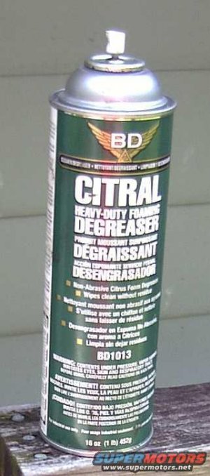

I've found a foaming citrus cleaners work good. Anymore I shy away from the cancer in a can brake cleaner/chemtool stuff.
Citral degreaser 2
