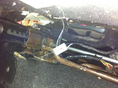

I've tried pushing back as hard as I can while holding the button, but it didn't budge a millimeter.
There is one connector I can see that isn't attached, but I couldn't find anywhere to plug it in.
HWHKN
(I have no idea why this is upside-down.)
I'll go investigate again.
[Edit] Yeah, everything seems connected except the cable pictured. We even pulled a plastic cover out of there that seemed wedged in such a way as to maybe prevent backward movement of the seat, but haven't been able to budge it anyway. [/Edit]

That connector is probably for the "auto-lock" feature that was on the gen2 ATX cars.
As far as moving the seat, it'll be tough if the switch is broken, but you'll have to jumper it at the connector. I'd use a 12V-14V drill battery. You'll need to experiment to find the right wires. Make sure you have about a 10 amp fuse at the end of one of your jumper wires to protect the motor.

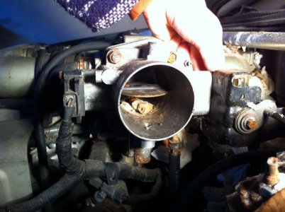

Some rodents got into it at some point while the intake was apart (and we still haven't located the end-tank for the intake) and really did a number on it. Here are the photos of the crap jammed in there:
EHkS2
I recognize my photos so far have sucked and I apologize. I promise I do know how to take a picture correctly. I just blame the dark and my iPhone for everything.
As you can see, barely, there's acorns and crap jammed in there. That nonsense makes its way all the way into at least one cylinder, and also some of the valves are destroyed for some reason, which I wasn't able to photograph, but I can try that again tomorrow.
