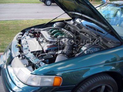

The best way is to have them off the car, clean them up real well a slight sanding have pieces hanging by wire and paint, allow to dry and give it a couple of coats.
The way it turns out is all about how much you invested in prepping.
Also use search function under painted intakes you should get a few threads with lots of pics and instructions.
Here's how mine turned out, I'd have to stress that the color combo will make or break the look no matter how well the paint turns out.
sideSHO
Jan 16, 2003
340
East TN
Tony.
You painted the intake and cam covers?
Looks really nice.
Looks as good as powder coat IMO.
