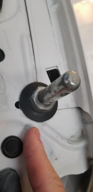

They were far from easy to install and they serve a functional purpose.
In fact my body shop said "never again" it was such a PITA for them.
Besides alignment and assuring hood closed/opened properly, they also had to hammer out/flatten out this crease formed into the frame member where the front quarters are mated to just to get the pin to sit in the necessary vertical position to line up with the hole in the hood.28af239827757ec1ca2caf1731aa7845

Hood pins are like a 1.5 out of 5 in the difficulty to install range. If you are unsure how to line them up, watch a YouTube video on the grease trick. I mounted my flush mount pins in maybe 30min

I watched Woman Driven on youtube put them on her Hellcat and she said it was not too hard. Sounds like the Taurus has some complicating factors.
