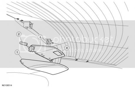

How do i replace the cover on the high mount brake lite ?It looks like the pass. side of the cover that fits over a stud broke off . The stud is still there and the cover is hanging by the drivers side stud. Don,t want to take it to Ford ,i bought the cover from a Ford supplier($30.00 cheaper) and if possible i will change it myself. Thanks ahead of time for any help.

What year is your SHO? I haven't looked closely at a 2013 or newer to know if they are any different than the 2010-2012.

For a 2011, here's what the factory service manual says:
2011TaurusCHMSL zps89dc0d8a
Removal and Installation
  1. Remove the LH rear head restraint. For additional information, refer to Disassembly and Assembly, Seat Backrest - Rear in Section 501-10 .
    NOTE: The high mounted stoplamp cover is attached to the base with hook-and-loop strips.
  2. Slide finger between the base and the cover to separate the hook-and-loop strip(s).
  3. Grasp the sides and pull the cover down to separate it from the high mounted stoplamp.
  4. Using a thin plastic flat-bladed tool, carefully unsnap the high mounted stoplamp connector from the rear window.
  5. Squeeze the 2 tabs and release the high mounted stoplamp from the rear window.
  6. To install, reverse the removal procedure.

Job done, Thanks to shorod for the help. New cover is on . I,ve traded the car in on a 2015 Grand Cherokee and did not want to leave it to the dealer to fix.Sure glad the guys on SHOForum are there to help!
