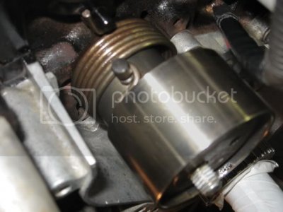

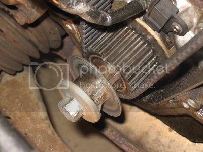

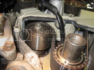

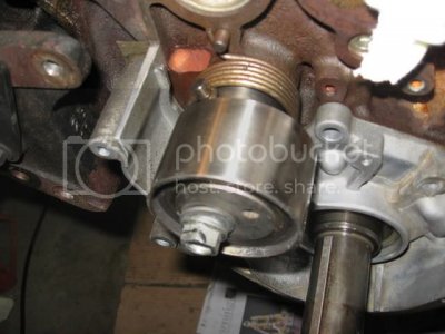

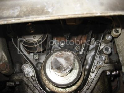

Hint: Get a cheap digital camera you won't mind getting grease on, and take pictures as you disassemble. Makes reassembly so much easier. These photos may show what you need to see.

Thanks everyone and great pics but the spring on the back of the tensioner as a little bend on it and that bend slipped behind the tensioner as i was installing it so it got stuck behind the it making it cocked. thanks again.
