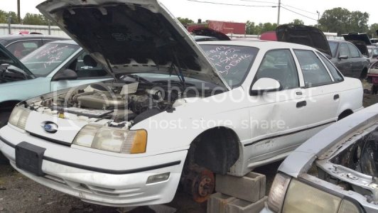

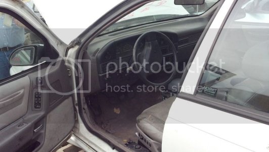

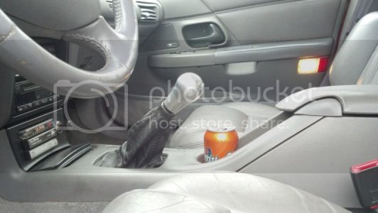

OK, in order to make the short cable completely usable I had to modify the shift lever to get more "throw" pulling back on the cable. I actually like how it feels... I seem to get more leverage while shifting. Enclosed is a couple of shots of the rare donor vehilce and how the shifter sits in my car while 2nd gear is engaged.

Where's that White 89, and why is it sitting in a junkyard? It doesn't look too bad; somebody needs to save that car!

Yeah, it definately doesn't look like it's in a Michigan junk yard, there's no rust on it!!!!

That white 89' is sitting in Cherry Picked Auto parts on Detroit Ave. here in town. It really isn't too bad, interior is decent, doglegs are good, there is some rust on the RR 1/4 and trunk and that dent in the driver's door. I have to assume this car didn't live in Ohio it's whole life either. Of course I still bump some cassettes in my converted JBL, I'm straight 80's *****.

once it hits that particular yard, its too late
stock front brakes, good window trim pieces.
somebody needs slapped upside the head something fierce

Ok, all of this distraction of a white 89 and I didn't realize that you have a cable shifter in your 95? Any particular reason?
