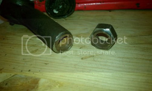

I had to get ahold of a nut splitter to get mine off....it happens.
How do you use a nut splitter on the nut that's already on the tie rod? The nut splitters I've seen are a closed loop how would I get it pas th outertie rod end?

Well I finally got that nut loose by fitting a pipe over a pair of vice grips and it finlly broke loose. Thanks for all of the advice
