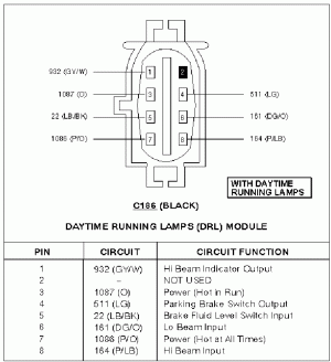

Here's the DRL plug. It would be easier to pull the fuse assuming the DRL module isn't shorted. Otherwise jumper pin 1 & 8.
Drl module c186 g3
