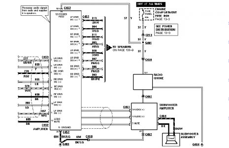

Hello, Just got my 1995 MTX, and I have to re-install the factory subwoofer to a harness that has been chopped. Can anyone help me with the wiring please?

Hope this helps. The silver amp is the sub amp. The grey connector is comming from the sub.
